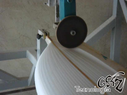

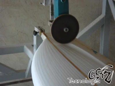

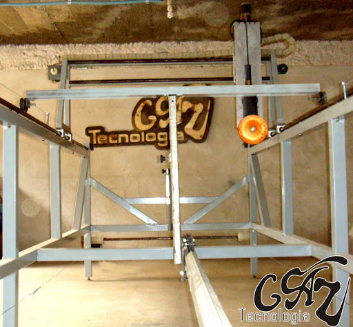

De lambuja, umas fotos da penultima máquina de usinagem de pranchas que eu fiz....
http://lh6.ggpht.com/_voWzOuW5W4w/S9srbpe857I/AAAAAAAAAOc/vpjNIBnOrGI/s400/DSC03143.JPG
Faca oscilante
http://lh5.ggpht.com/_voWzOuW5W4w/S9sr6cfYwzI/AAAAAAAAAOk/B6YbRYe-zU4/s400/OgAAAMmeU84sKcKghzoIBCjgGlR2IWYSj-IGNOyYI7HUQfJkoJSfLFvu6pmf_QLFmVGWFo15qH7fwVb7TpKhAaHKrkYAm1T1UH7nwsRPSq2FQg9QlFZXtHCCroJD.jpg
Faca oscilante
