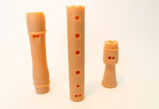

Alguns trabalhos
http://4.bp.blogspot.com/-qjy034DBuAE/Ta1rhqqmaFI/AAAAAAAAAPI/4BR8oCquclI/s320/IMG_6954.JPG
Impressora 3D homemade com Projetor DLP
http://eckiller.com/wp-content/uploads/2011/04/61f7c2323dprintbust.jpg.jpg
