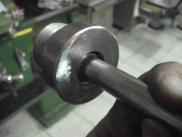

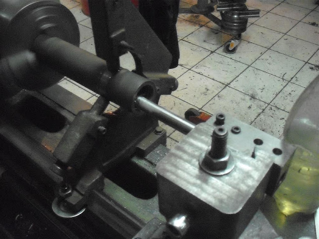

avanços
material do pistão
https://lh5.googleusercontent.com/-qkCthVmqL3s/UCB4toV2dQI/AAAAAAAADTA/0DZ8cuTUpuo/s640/DSCF5251.JPG
serra fita homemade para metais by HSC
pulo do gato... valvula de esféra
https://lh3.googleusercontent.com/-dc-ausE0XuI/UCB4vaSRdlI/AAAAAAAADTI/4gvk3IhHLCg/s640/DSCF5252.JPG
mandrilhando / rosqueando a camisa do pistão
https://lh5.googleusercontent.com/-neLf3rlWKKg/UCB4xqCy6dI/AAAAAAAADTQ/3pOOKjiPbc0/s640/DSCF5253.JPG
zoia
https://lh5.googleusercontent.com/-xHyLBe30kRw/UCB40XE36hI/AAAAAAAADTY/HoUfDemIWZo/s640/DSCF5254.JPG
https://lh6.googleusercontent.com/-nsuRbBDwVXk/UCB412FeAfI/AAAAAAAADTg/Mn-kIG2QUa0/s640/DSCF5255.JPG
raspador
https://lh6.googleusercontent.com/-91_YCCeUyR0/UCB44O_ZBFI/AAAAAAAADTs/6t1i-_pMrDE/s640/DSCF5256.JPG
gaxeta na casinha... num forcei pra entrar pq tá sem trava.
https://lh4.googleusercontent.com/-E3icgSHtuS4/UCB466zAOKI/AAAAAAAADT0/Q-Pr5rhl-Ww/s640/DSCF5257.JPG

el piston funcionou bem pra kct !!!
